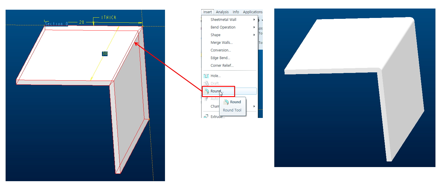

I made sheetmatal model using extrude without "add bends on sharp edge"
And added round at edge with small radius than sheetmetal thickness
After that I could not make unbend
How to do?

Please refer the following image.
I created sheetmetal wall using extrude and thickness is 1.
And I added round to sharp edge and radius is 0.8.
After I click "flat pattern" but I could not make flatten
Please check and give me good solution.
Thanks.

To get a flat pattern, you must have constant thickness for sheetmetal (by definition sheet metal is a constant thickness material. When you have a round on one corner and not the other, you have made a non-constant thickness.
My opinion is if you want a sharp inside corner, use the option to add bends and use a 0 (zero) bend radius on the inside.
Your outside radius will be the material thickness since that is what is required to keep a constant thickness.
