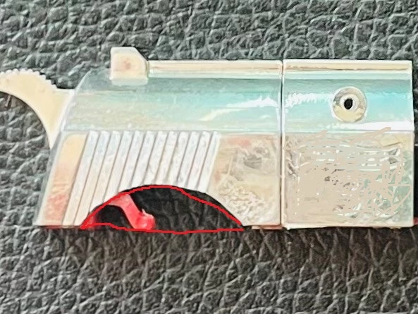

Hi all,
I have a broken piece I need to fix. How can I superimpose the pic in sketcher to draw exact profile to match and give me a accurate or close match. I have to make the red piece (See Image). Thickness is known (1.2MM).
This can be a good lesson for reverse engineering.
Copying the existing for  upgrade .
Thanks in advance.

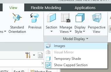

In the model, go to View, Model display, Images, you'll have to "scale" the image to get the size approximation. right and placement is always fun, but it works well.

Once you place the image use Creo’s image scale button (in the image ribbon) to resize the image horizontally to exactly what you want. No need to do this outside of Creo.
