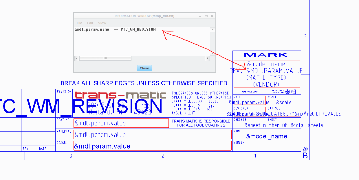

Marc,
I feel your pain. I went round and round with PTC on this same issue. It was like talking to a brick wall. There is a fundamental problem with having the same parameter name exist in both the drawing and the model. This is exasperated when connecting to Windchill where system parameters are instantly created as soon as the object is loaded into session.
One workaround that will keep model parameters from snapping to drawing parameters is to use a single cell repeat region on the format (or template) for each parameter. Set the cell value to &mdl.param.value and then create a filter specific to the parameter you want to display. For example, "&mdl.param.name == PTC_WM_REVISION".
Unfortunately this workaround doesn't help any with the drawing program. For that I've simply settled on a set of mapkeys.
My case history is attached if you feel like reading it. Be warned, it's long and frustrating!
