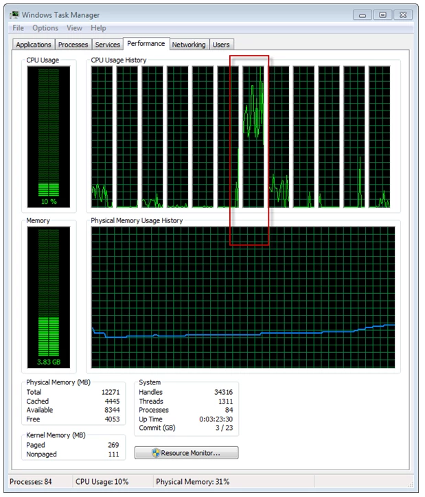

I have a new Z600 workstaion with Windows 7-64that has a quad-core processor with 12 CPUs shown in the Performance windows of the task manager.
The problem is that only one of the 12 CPUs is used at a maximum of 8-10 percent.
I am working with WF5 and tested it while running a Windchill session and a standalone session and both show the slow performance.
There are no search paths, everything is local. While deleting components at a large assembly, the regen at 8-10% can take over 30 minutes.
Because Pro/E is compiled single threaded, it can only use one of the 12 CPUs (in this Z600), but it should use the single CPU at 100%.
What is causing Pro/E to utilize only a fraction of one CPU?

November 26, 2012
It looks to me as if t you are using one CPU at close to 100%, and are
using all of the CPU's at approx 10% of total. No problems here, one
CPU at 100% would only be 1/12 = 8% of total.
