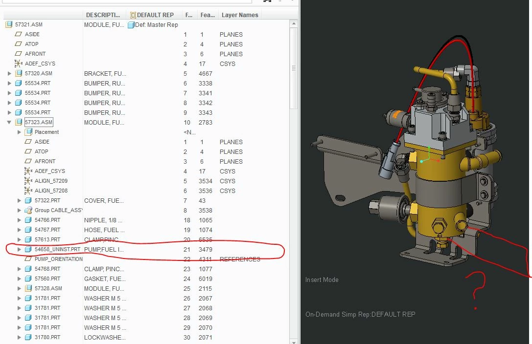

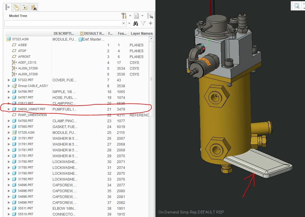

Hello, I am using Creo Parametric 3.0 M150 and having some difficulty with a hidden part.
I have a main assembly where a component in a sub assembly is hidden and I can not find a way to show it. The part is visible when the sub assembly is open. It is not on a layer, it is not hidden, there is no simplified rep substitution hiding it, the master rep is active, there is no family table, the appearance is something I can see. I am at a loss as to why this part is hidden. I have obviously missed a trick somewhere. The user who did this is no longer with the company. I am wondering if there is a tool not on the toolbar he used. I found he never used simplified reps and always chose to hide the component in the drawing.
cpoirierAnswer
I found it! It is an assembly cut only cutting the component that is hidden. The system says it was made in this assembly and gave me the feature name, I found all this by selecting the feature>rt click> information>references, I'll find the silly thing using the search tool next. Please pardon me but why the expiative, bleep bleep would anyone do this? I used model player and it briefly showed up, this was a hint. Oddly I went to far and canceled out by mistake. After canceling insert mode and slowly using model player it did not show up a second time probably clicking around too fast. That's odd, but par for the course today.

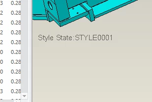

The pictures you took show that you are in insert mode with a simplified rep active.  Are you *positive* that insert mode is not active and you are in the master rep?  (It should show master rep in the text on the screen.)
StephenW
With respect to the visibility of a part similar to component display/blank, these is the style command in the view manager, but it should also display on the screen that you are in a Style State.

Found it, it was an assembly cut.
