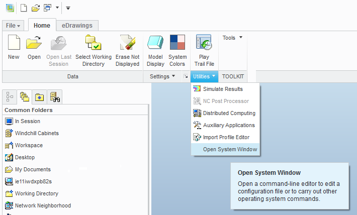

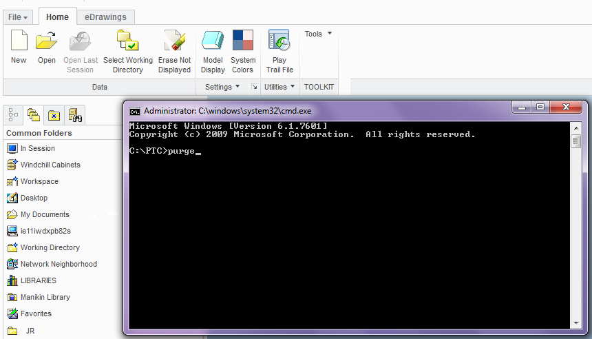

January 28, 2016
Open system window. Type purge and enter.
All the older versions will be removed.
