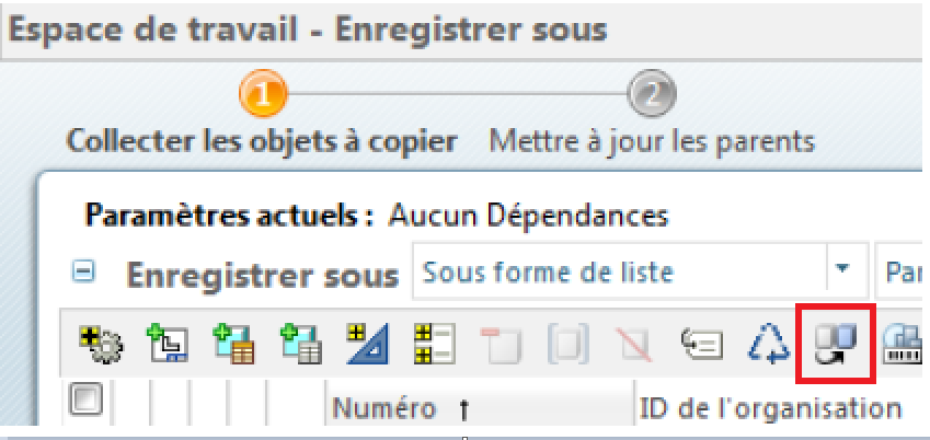

If the replacing component has the same construction of features in his modeltree as the original one (same features with same FeatureID, just dimensions modified),
You can do the replacement automaticaly via the "file==> save as" command of Windchill, if your are using windchil...
