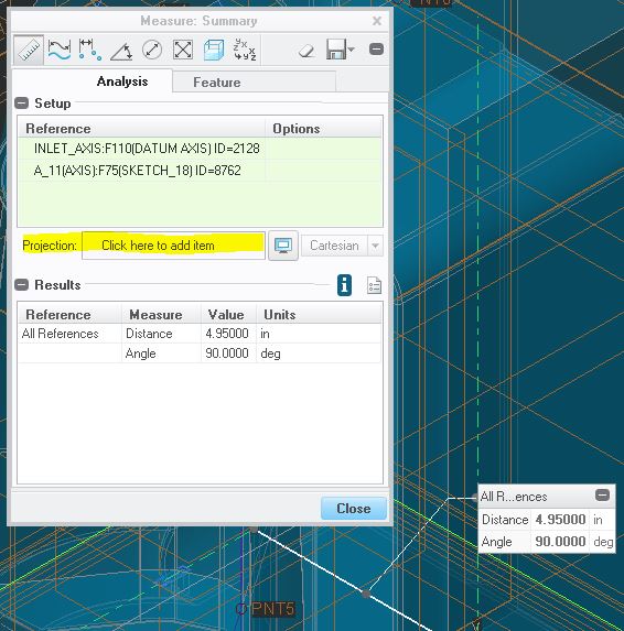

I need to measure distance between two axis but get results in X,Y,Z, coordinates.

I need to measure distance between two axis but get results in X,Y,Z, coordinates. I saw that this was doable in Creo parametric 2.0 but can't find it in Creo Parametric 3.0, any thoughts?

It's in the center of the measure dialog.
March 30, 2016
When I use either the distance or summary measurement tools, I get a distance between any two axes.  The summary tool also gives me the angle.
Are you specifying a coordinate system in the projection box?  That's the only way I get the X, Y & Z.
bcooper1-VisitorAuthor
March 30, 2016
I don't see that option.
March 30, 2016
