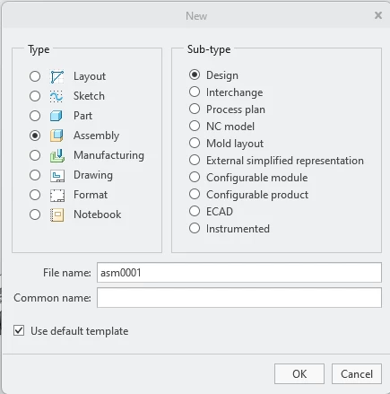

i would like to understand the template names when starting a new document
i would like to understand the template names when starting a new document. is there a reference to all the template names (eg mmks_asm.design_abs and all the other variants)

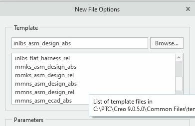

Here is some information about template names ( Predefined Systems of Units).
There are two Unit Systems:
Mass length time (MLT)
Force length time (FLT)
MLT ( Custom System of Units). If you choose the MLT unit system, then the name will be LengthMassTime. If you choose the FLT unit system, then the name will be LengthForseTime
Here are some useful information about Units in general ( About Units)
There is also the part/assembly type
Finally, absolute tolerance vs relative tolerance (Absolute and Relative Tolerance Settings)
So the template name is as follows
MLT unit system: LengthMassTime_part/Ams Type_abs or rel.
Force length time (FLT): LengthForceTime_part/Ams Type_abs or rel

3-Newcomer
Dec 10, 2024 7:25 AM UTC
template names.jpgok, i was more so looking for these explanations, mmks, mmns, list goes on

Michael16-PearlAnswer
Dec 10, 2024 11:14 AM UTC
They are abbreviated
in = inches
mm = millimeters
k = kilogram
abs = absolute accuracy
rel = relative accuracy
n = newtons
s = seconds
and so on.
