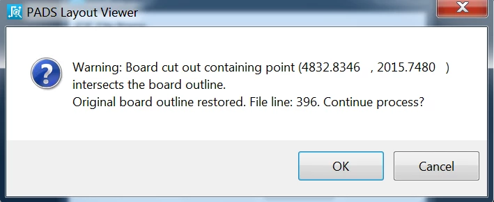

This has been quite a headache in our company, but basically we are having a lot of issues when we export the emn file from CREO to PADS (attached).
1. I have checked with PADS support and they have said that the issue is not on their end.
2. The PCB that we use, is actually three different sides which are then merged in the part. can this be an issue?
I can also share more details but I would really like to know if someone has encountered that problem before?
