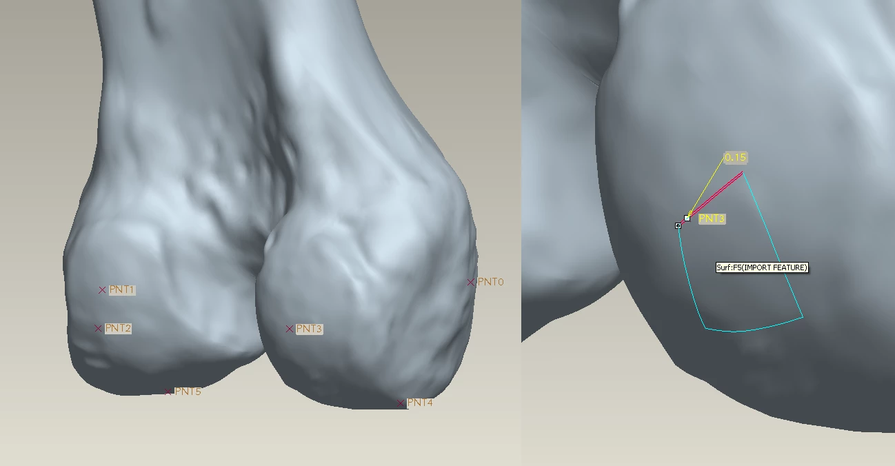

I have a CT scan of a knee, and converted it to an IGES file. The goal is to select landmark points on the knee as seen in the attached image. Unfortunately, when I try to create a point, Pro/E will only allow me to select 1 edge (red line) of a 'rectangular' surface on the IGES knee file. I want to create a point inside this rectangular surface, but I have not been able to figure out how to do this. Please let me know if you can help. Thanks.

Project curves onto the surface and then you can place points on the curves.
