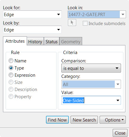

Sometimes the open edges of a quilt are too small to readily see.
Use the search function to find these edges:
CTRL+F activates the search tool
In the search dialog, look for "EDGE" by "EDGE" with the type "ONE-SIDED"
Then hit the "find now" button.
This will highlight every open edge in the quilt.
