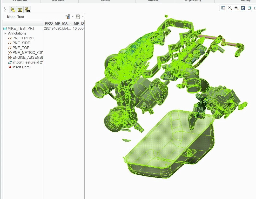

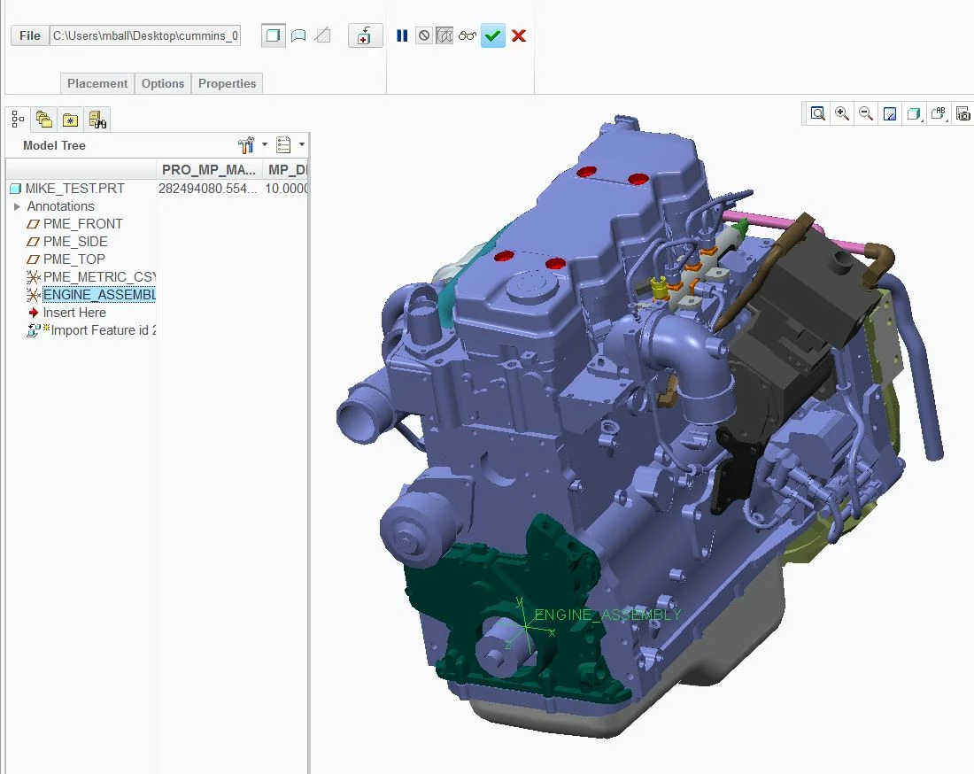

Hello all,
I have imported an .iges file (engine assembly) that looses much of the geometry when opend. However, when I "Edit Definition" of the import feature all of the geometry becomes visable for manipulation in the IDD... Any ideas how/why this is happening? Obviously I need to get all of the data visable.
Mike

One likely sequence:
A number of the components are not solidifying, so they stay surfaces/quilts +
config option to place surfaces/quilts on layer +
surfaces layer is hidden.
Also - the mass seems a tad high.

Thanks for the quick response, and sorry about my the spelling mistakes in the original post.
Back to the model. It's not a layer issue. I am thinking all of the purple geometry (when in IDD) are quilts. I guess that I need to solidify those objects somehow. The weird thing is the engine block was a solid when the iges file was created.
