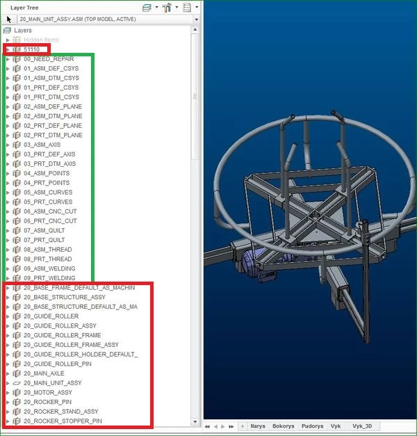

is there a way to import assembly ONLY with layers that are determined in default template? Let´s say IGNORE all layers from step/iges and use only our company layer settings.
Notes:
1) Customize layers VALUE=IGNORE during assembly import doesn´t function. I tryed it and it imported all layers.
2) Deleting of imported layers (even through macro) is time consuming.
Thanks for a reply ....
Best answer by VladimirPalffy
It is possible configure ModelCheck and then system crate filters for your assembly/part layers (you can remove unnecessary layers, set state etc.)
Vladimir
March 15, 2013
Vladimir
