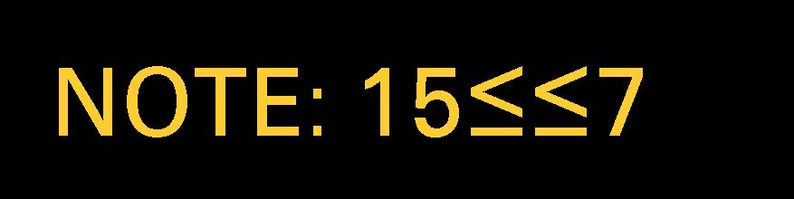

Okay, that's not on my keyboard, Matt. How'd ya do that?
November 14, 2013
Hold ALT and type 242 (≥) or 243 (≤) on the numpad and let go of ALT.
For the above note I had to find a font that supports those chars, otherwise you just get a square.(I think it was the last font on the list of fonts).
If you want the list of chars, google ASCII table or Unicode table, etc. there are a lot of them.
