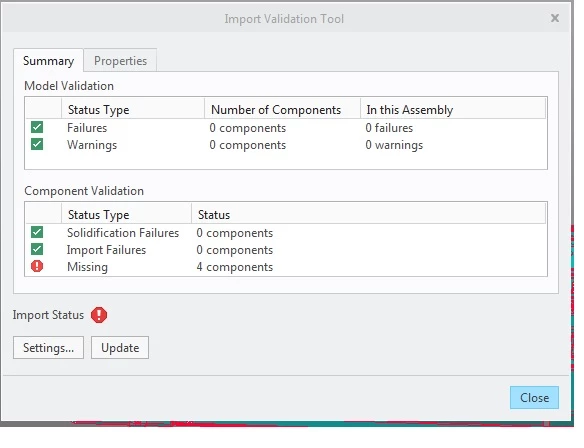

We are changing our models from Solidworks to Creo. However after importing the assemblies we are getting RED exclamation mark in the tree and in the the Import Validation Tool.(see attached)
The missing part in question were deleted out myself ,because of solidication issues. I have redrawn them in Creo and replace in assemblies however the the missing error still appears..
Is there a way to remove this error or what file does this tool uses to cross referances to see if parts are missing.
Thanks for the help.
John

Did you tried using UPDATE in Validation tool?
John41-VisitorAuthor
October 24, 2017
Yes I did, I have now found that I had the ATB box ticked and this was linking back to my Solidwork model somehow.
I tried to make independant. Didnt allow this so the only solution is to reimport without the ATB box ticked..
