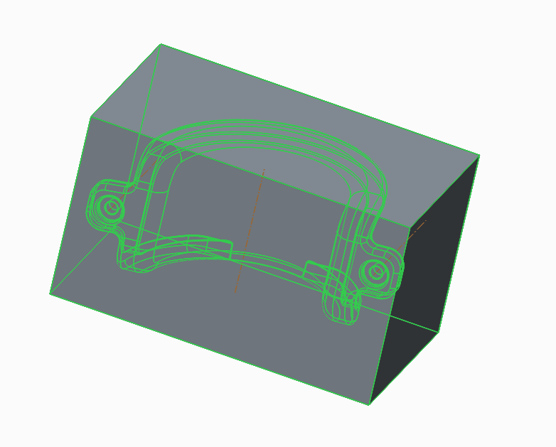

Imported feature has a volume of 0.00

I'm attempting to take an igs file and build a mold around it in Creo 1.0, but when I use the cutout tool it doesn't actually remove any material to the other part in the assembly. I can see the outline of the first part outlined afterwards and the software says "Cut out has been created successfully." But when I do a volume check the second part hasn't lost material - and if I cut away part of that piece the cutout doesn't go with it. I've attached the IGS file and my assembly, and the screenshot is of the mold part with all features highlighted.Capture_6.PNG

There's probably a hole in the surfaces that prevents it from being solid, and with it from being used to cut out material.
Use the Import Doctor on the feature to check for and repair - missing surfaces, unattached edges, et al. You may also patch missing surfaces by creating separate surfaces and then attempting to Solidify the part. If Solidify works, you're done. If not - keep looking.

Thank you David, that was exactly the problem. Well, sort of - the model apparently had a few extra surfaces that weren't tied to a component that were keeping me from using the repair function. Once I got that sorted it all worked out nicely.
