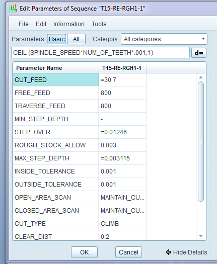

What I have set up is a system for calculating speed, feeds, and program header infomation which takes gobal parameters from the part and the manufacturing assembly.
Assembly parameter table
Section of the relations
Example of header generated
This also calculated the feedrate by setting a speed range letter, and each of the manufacturing parameters link to assembly parameters, we also take parameters from the part to calculate diameters for the speed calculation.
Th aim is to automate as much as possible.
it is the assembly parameter table which I woul like the ability to import, I can save it, just can't reload it.
The relations are fine, I actually have a dummy relation file loaded, with all the calc commented out, and when I am finished, load the activated file and regenerate the model, it works.
