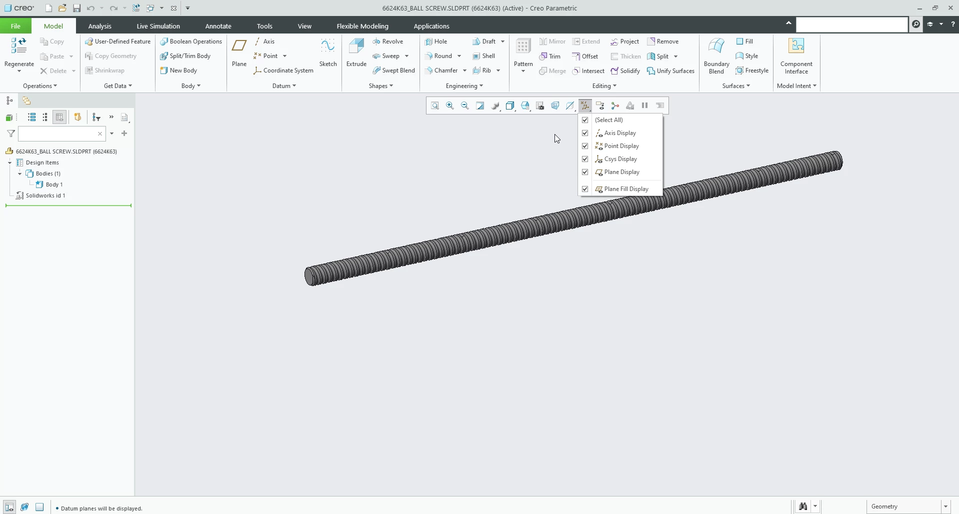

I'm in a situation where I have to modify a SOLIDWORKS part from Mcmaster using Creo Parametric. I successfully imported the SOLIDWORKS file into Creo, but it appears as a 'dumb solid' and I don't see any original planes that were used in SOLIDWORKS.
Has anyone else faced this issue? If so, what's the best way to go about creating planes for modification purposes?

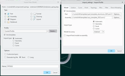

I typically import McMaster-Carr models as "STEP" and use a template, so that the model will come in with planes and layers as per my company standards.

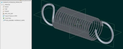

I assume the 3 planes are the original "default planes" from the Solidworks model:

Are doing an Import into your company standard start template file or opening the SW file directly in Creo?
My users have been instructed to always create a new file, then do the import into that file when they import things from McMaster-Carr.
