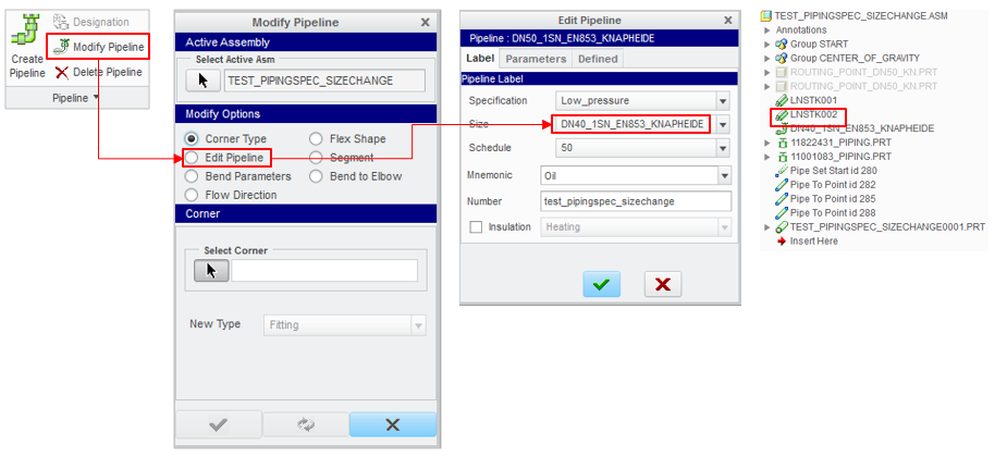

When working in Piping driven by specifications, to change the tube size, two main steps should be followed (in my exemple i wanna edit the size from DN50 to DN40) :
1 / Modify Pipeline => Edit Pipeline => Size => i choose the size i wanna move my tube to (DN40 in my case).

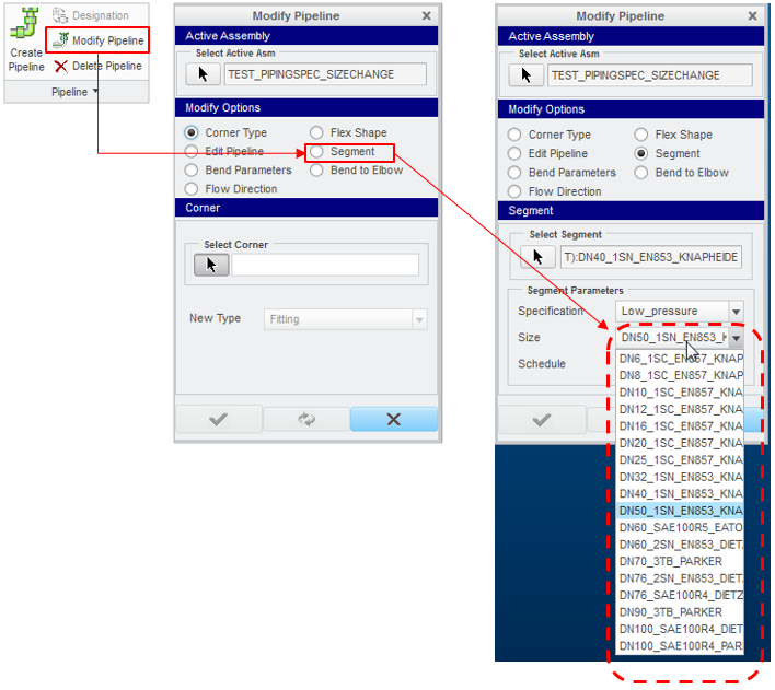

2 /  Modify Pipeline => Segment => Segment Parameters => Size => i need to rechoose DN40 from the list shown
In the Size list in step2, can you limit the choice to only the old size (in my example DN50), and the new size we have chosen in step1 (in my example DN40)
Having multiple choices in size menu can be  confusing/lead to errors.

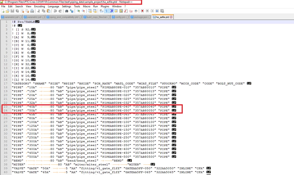

In order to limit the number of SIZE choices displayed in the "Low_pressure" piping specification, you need to go edit the resource text file (.ptd for Creo 2/3 or .csv for Creo 4)  in the piping directory folder (see below example spec file). If these spec files are not local to your computer and your administrator deploys these files, they will have to make the change. You can either delete the sizes you don't want, which will affect all current and futures usages of that spec or create a new spec resource file, maybe called "Low_pressure DN40/50" with only those options and select that as your specification.
Currently, there is no out-of-the-box way to remember your prior choices in spec-driven piping, but there may be ways to automate this. My company focuses on Spec-Driven Piping solutions (RsysConfig) and we may be able to tailor a solution for this.
