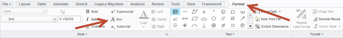

Hi William,
In Creo 3.0, when you create a note, the Format tab appears.  Within this tab, you will see, in the Style group, the option for Box.  Select this prior to entering your note.
Amit
