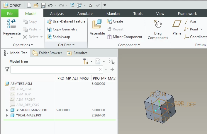

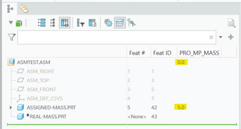

I have a case open at PTC showing inconsistent assembly handling of component mass. See article CS396826.
The problem occurs for a component with no solid geometry and an assigned mass of some value and with 0 for the assigned volume.
I have attached models.7z with a sample assembly (asmtest.asm) with 2 components:
  • assigned-mass.prt
    • model with no solid geom and an assigned mass of 5.0
  • real-mass.prt
    • model with actual geom and mass calculated the "normal" way
  • These models have been created with Creo Parametric 6.0
  • You will need to set config.pro option mass_property_calculate automatic

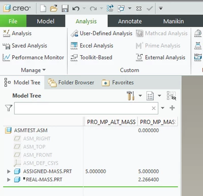

If this is the only component in the asm then it's assigned mass is not used by the asm. Screenshot (Creo Parametric 10.0.1.0) showing the asm mass of 0 when real-mass.prt is suppressed and note the asm has 0.0 even though assigned-mass.prt is showing 5.0.

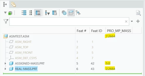

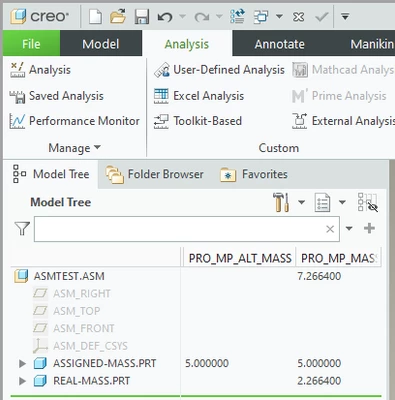

After resuming the real-mass.prt the asm mass now correctly has 7.2664 which is including the mass of the assigned-mass.prt:
So we have shown the asm level mass has inconsistent behavior. I have tried Creo Parametric releases 6.0 thru 10.0 and all have this issue - have not tried any earlier releases. I want to hear your opinions on "Is this a bug or not?"

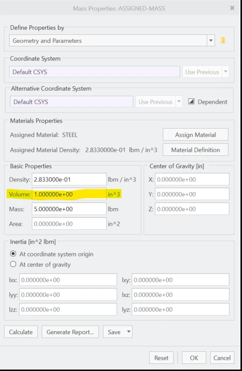

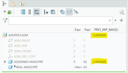

The workaround is to add a dummy volume value to the assigned mass properties which is what we are doing:
After doing this the asm mass now is showing the mass of the assigned-mass.prt as expected. It is using the assigned mass (as I would expect) vs the mass you get from the density x volume:

tbraxton
Aug 3, 2023 3:29 PM UTC
Have you run a report using this config option to verify that Creo is handling the component with assigned mass when getting the "wrong" result?
Set the configuration option mp_calc_level to all_models to include the summary of assembly components, details of assembly components, and the summary of bodies in the assembly mass property report, and the summary and details of bodies in the part mass property report.
20-Turquoise
Aug 3, 2023 3:49 PM UTC
Running a mass properties report shows the same inconsistent values for mass.
Setting mp_calc_level to all_models makes no difference - still shows the same inconsistent values for mass. As shown in POR_MP_MASS and in the mass properties report.
tbraxton
Aug 3, 2023 5:27 PM UTC
Using Creo 7.0.9 I get these results using your test models. It appears that something is not right with the way this works (unless PTC has documented why this is happening). I saw nothing in the help files that explains why these results are not as expected.
I suspect it is working to PTC specification due to the fact that your assigned mass model does not have solid geometry in it. If you add some solid geometry to the assigned mass part model, then the calculations behave as expected (see the last screen shot). I have used assign mass but never in a part without some solid geometry in it and it has worked as expected for MP calculations. I believe the intent of assigned mass functionality is to be used for a model with some solid geometry. Please report back what the response is from PTC support when you get an answer.
