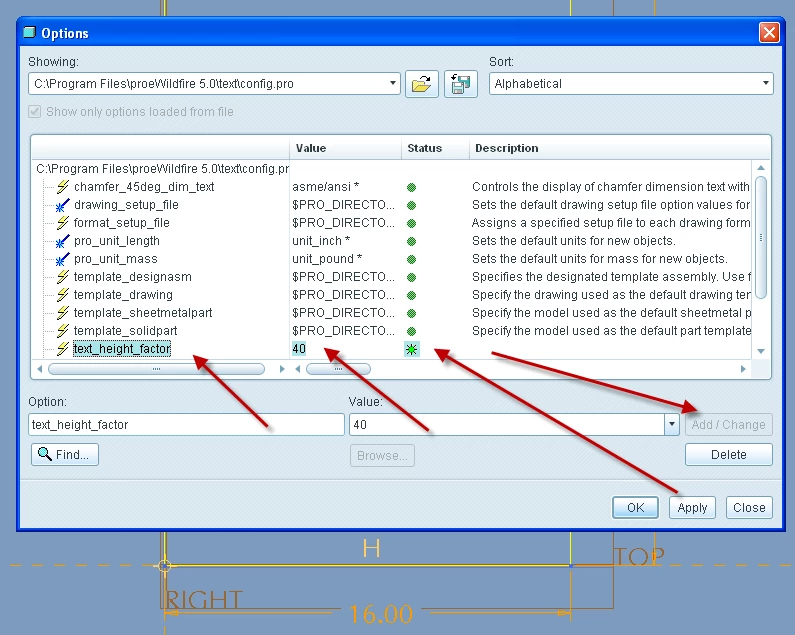

This is going to be great information for classroom projection. (heck - I needed this for my desktop, let alone lab projection)
Took me a bit to figure out how to change it (see attached).
Need to start new part for sketch specific changes and restart program for program interface specific changes.
