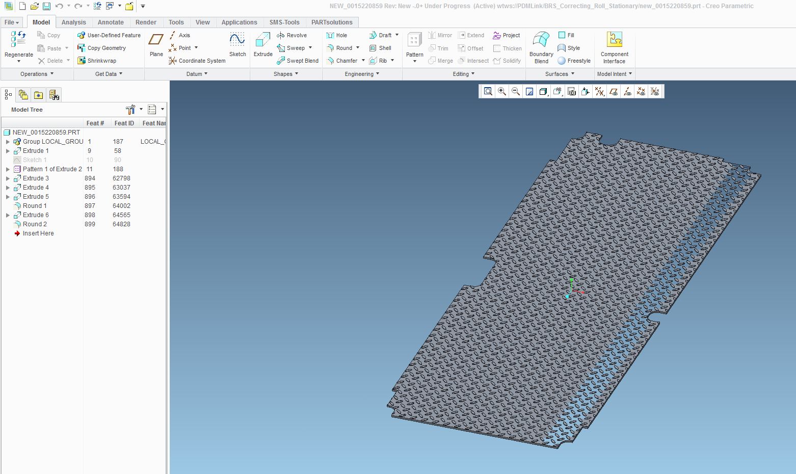

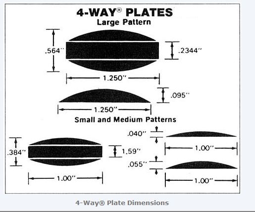

Does anybody out there happen to have a file showing the correct modeling of Inland 4-way plate medium pattern? I have looked all over the net trying to find something, with no luck. The Ryerson catalog that I have shows the correct dimenisons for the lug, but not on how to space the lugs from one another. Any help would be appreciated. Thanks!

Okay, I was able to generate the pattern I was looking for, but now for some reason there part is partially transparent down one of the sides. Can anybody tell me why?

I would suggest contacting the manufacturer and asking for a pitch guide for the various plates.

Now that's new Actually, this is a long time problem with graphics. One of the settings in your feature is modifying the surface and at certain locations, it reverses the normal of the surface. If you took a different tact on your feature creation, it might work perfectly.
What did you find out on the pitch? Did you get an official pitch pattern from the manufacturer that you can share?
