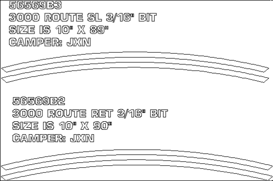

I'm trying to insert an image into a drawing and I can find a way to get the image to show. No matter how I insert the image all I get is this.
route+bad.jpg The image file name. I want it to show the actually image.
I have tried getting them image by importing an AutoCAD drawing, but when I do that the image does not display at all. I have also tried inserting an object and thats when I get the image of the file name(see above). I have tried several file types and none seem to import the actaul image.
If anyone has any suggestions I would appreciate it.

Hi James,
Please try to insert Bitmap image (*.bmp) instead of JPEG (Insert > Object > Create from File > Choose the image in .bmp format).
Mahesh

Hello James,
I think this is an Issue with Windows, open the image up in paint, and whilst it's still open insert the image into your drawing. (There is a registry key you can change to fix this I believe)
Tim

Thanks guys, I was able to get the image in from paint. Now the issue I have is that I lose the detail from the image. I kind of expected this, so I'm going to go a different route.

April 2, 2014
You can set the resolution for images in drawings also. By default it is only 150 DPI.
See this post: How to insert a PDF in detail
To get a good .BMP image I scale the source up to look good on the screen and do a screen capture. I can usually preserve that level of detail without issues.

Thanks Antonius, but my image problem isn't with Creo it from the program I am pulling from. Since I don't have access to our image software, I have to copy the image from another software, then pull it into Creo. Turns out that is where I am losing the image quality. So now its a personal problem for me not a PTC problem. I hate when that happens.
