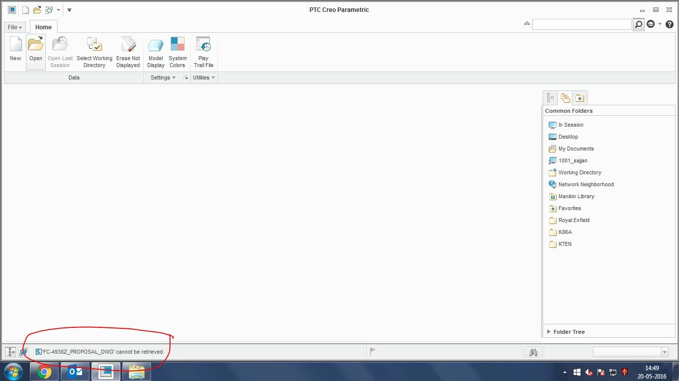

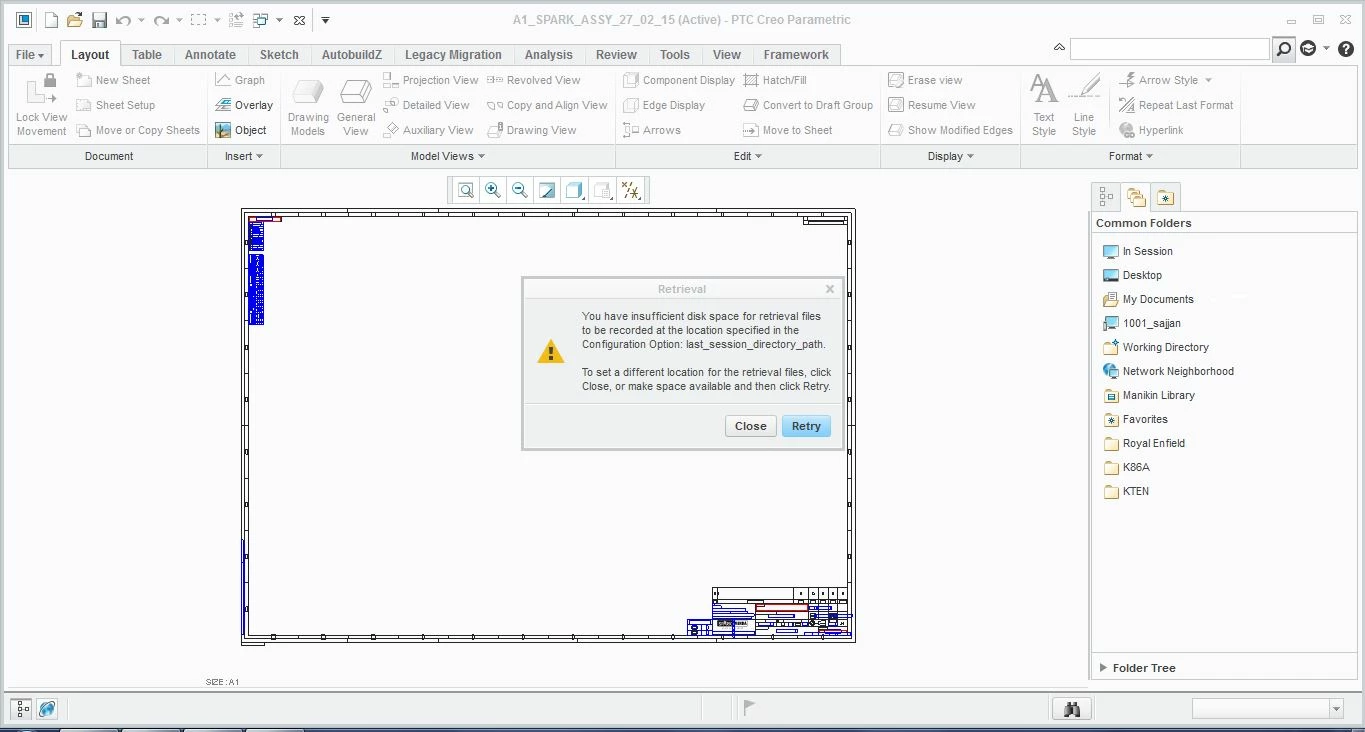

I open the drawing then there was a message popup
"You have insufficient disk space for retrieval files to be recorded at the location specified in the configuration option: last_session_directory_path"
and then file got corrupted.
May 20, 2016
did you check last_session_directory_path option in your config.pro file ? Where does it point ?
If you can't find the option then data are probably saved into %APPDATA%\PTC directory.
You can also set following config.pro option to disable saving "session data".
LAST_SESSION_RETRIEVAL no
