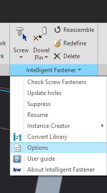

Just got a full licence of IFX and have the following issue :-
I want to place a fastener in an assebmly by mouse click then dimesionally change the position of this fastener.
How can I do this????

Hi @ptc-174577,
try to change one option. Therefore goto Tools -> Intelligent Fastener -> Options
and change ENTER_DISTANCE_VALUES to YES
Hope that helps
Greetings Sam
Greetings Sam
September 18, 2017
You edit the axis that it creates based on your mouse click.
