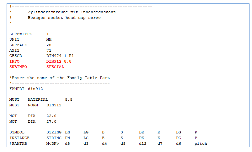

I'm looking for information on what parameters can be modified or added to the data base of fasteners in the FULL version of Intelligent fasteners.
Can I add my company part number, have similar size fasteners with different grades, different coatings, etc.?

You can add any parameter you want in the full version.
With the entry INFO you can define the name that will be shown in the selection dialog box in IFX.
The SUBINFO gives you the possibility to define a column to make a selection box within IFX. It is therefore possible to use the same dimension and length of a screw with different parameters e.g. MATERIAL.
In this case a dialog will pop up if there are two parts with identical diameter and length but different value of the parameter SPECIAL.
This is an example of the dialog:
Hope that helps, Jim
