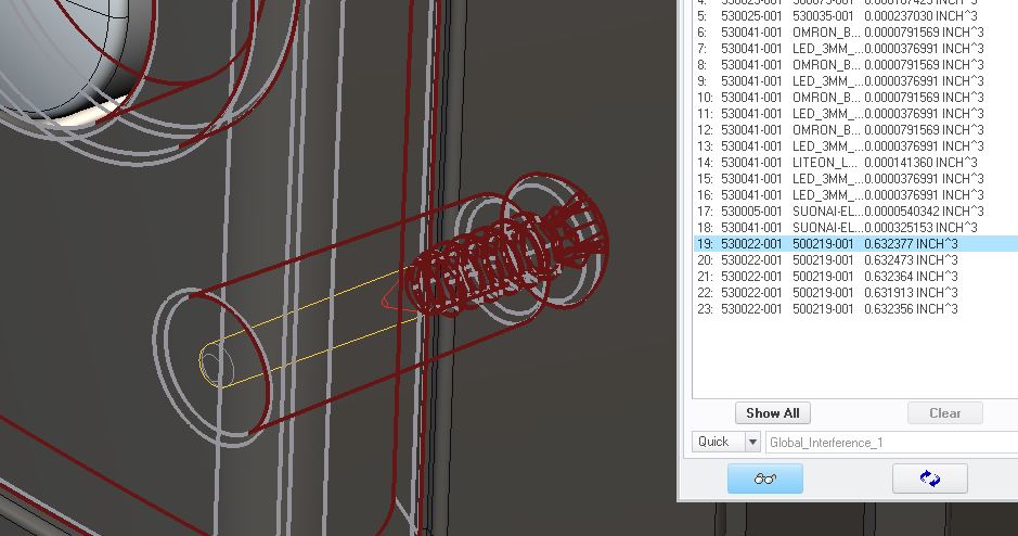

When I do an global interference on my assy, two parts report a very high interference, about 7.5 cubic inches.  There is no clear interferance between the parts. This value is consistent between a global interference or pairs clearance checks ,whether at the top level or at the sub assy level.  I created a cut out of one part into the other, which should eliminate all interferences and it still reports the same value. In fact, it turns out the volume reported is exactly equal to the volume of the two parts together. For some reason Creo thinks they fully overlap when they clearly do not.
Has anyone seen this before and have a work around?  My concern is trusting the analysis in other areas, or missing and actual interference between these two parts because I assume this is just a glitch.

This may sound silly, but are you in an exploded view or a drawing snapshot? IE maybe the parts really are overlapped?
Have you tried putting them in a brand new assembly with a distance of 100 units apart?

No, in fact I've since seen it in another sub-assy in the same database. This time it was with screws where I'd expect a small interference, but it showed the entirety of both parts as overlapping.
Unfortunately, we are not current on maintenance so I cannot send it to tech support to evaluate.

OK, it seems that today, after shutting a restart of both Creo & my laptop, I cannot reproduce the issue in the the initial assy, but it remains in the other.  No changes have been made in any of the components involved.
Here's a detail screenshot of the two parts, a screw (McMaster download) and a plastic panel:
Interestingly, the reported interference between multiple instances of the same screw is not identical, but very close. The volume of the panel is 0.629878, the volume of the screw is 0.001687. Combined volume is 0.631565.  In the first occurrence the reported interference was exactly the combined volume of the two parts (both molded parts in that case), in this case it is not.

Just out of curiosity, did you download a Creo model from McMaster or a neutral file (STEP or IGES)?
August 6, 2015
STEP file.  it is solid with no geom checks.  It was created in WF4.
Keep in mind, the first occurrence was with two native Creo files.
