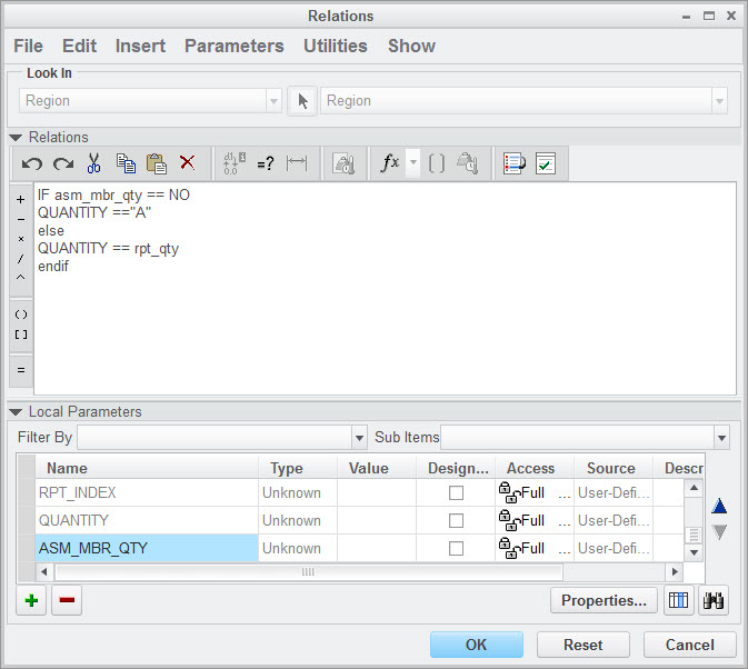

Best answer by Mahesh_Sharma
Hi Antjuan,
Possibly the reason for error is missing asm_mbr_qty from local parameters for Repeat Region relation.
1. Repeat Region > Relation
2. Add asm_mbr_qty and QUANTITY under local parameters (if relation still fails, set the parameter type as String and keep YES in quotes)rel.jpg
IF asm_mbr_qty == YES
QUANTITY = "(REF)"
else
QUANTITY = rpt_qty
endif
