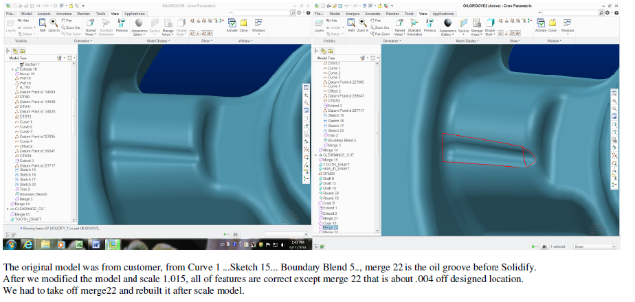

I used scale model in one job, but some features (surfaces) didn't scale up correctly. Is the scale model a good tool? thanks.
September 11, 2014
Threads may have a problem with this. In general, it is nice to use for accounting for shrinkage or even thermal expansion evaluations. I'm sure there are other tricks that can be performed with this but in general, it should only be sued for a very specific action.
Can you share what didn't scale accurately for you?
