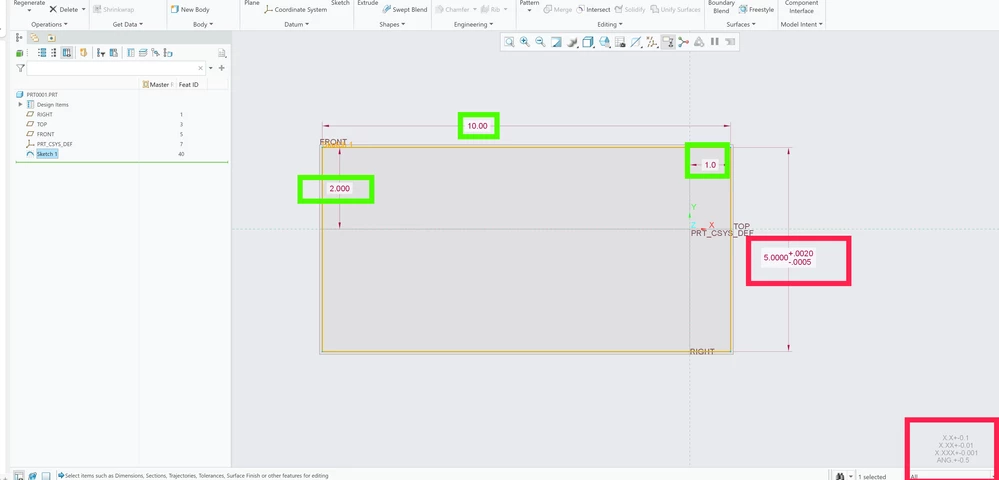

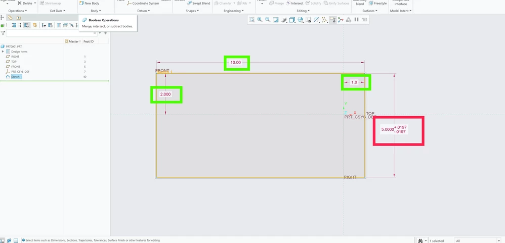

A new inlbs_part_solid_abs part with a rectangle sketch. Tolerances in green boxes are assumed by the number of decimal places. The red box has an explicitly set tolerance.
Upon changing the standard to ISO in model properties, the red tolerance gets overridden, whereas the ones interpreted by the number of decimal places keep their same number of decimal places.
