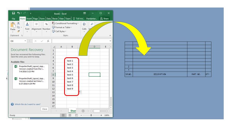

Hi..
Is it possible to copy data from excel to drawing table as below,
Prashant pandarkar
kdirth
July 7, 2016
Save Excel table as CSV.  Select Table From File, change Type to CSV and locate saved CSV.
July 7, 2016
Hi..
I want to copy only one column, because my half table is repeat region and half is editable.
so i want to copy only one column from excel to creo drawing.
.csv method already tried but we can not maintain repeat region in .csv method.
Prashant Pandarkar
kdirth
July 7, 2016
I do not believe there is a way to combine tables.  You will need to manually cut and paste text from excel into individual table cells.
