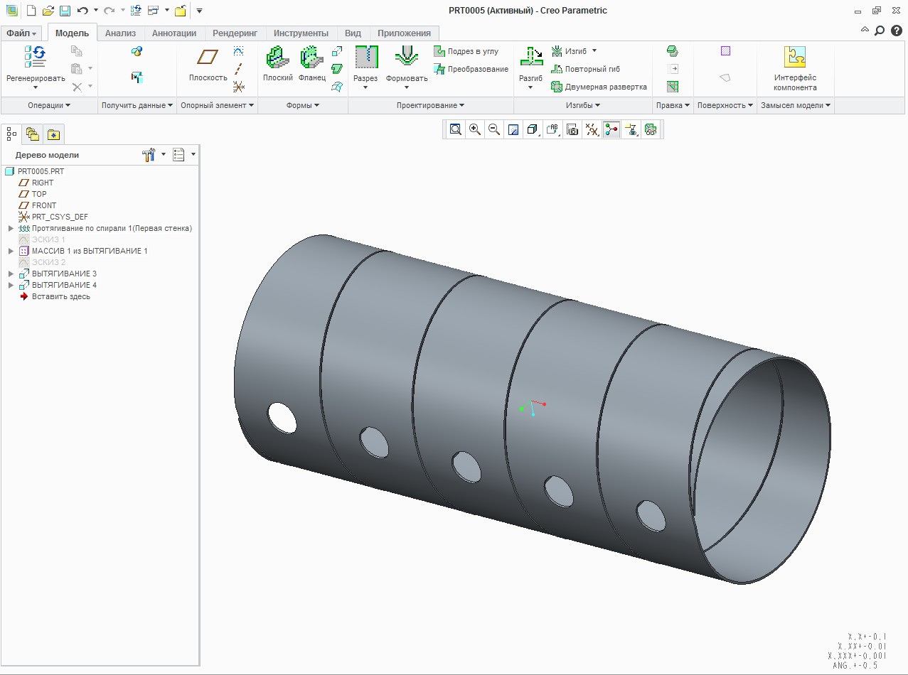

Hello, everyone!
Is it possible to create a flat pattern of a helical part in a sheet metal module of Creo Parametric?
Thank you in advance.
Best regards, Vladimir.

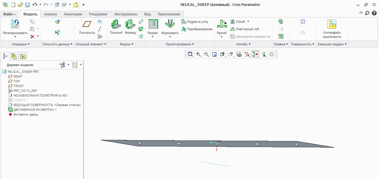

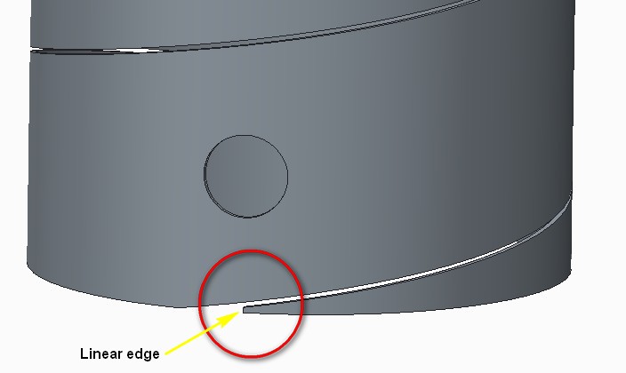

Kris, you were right. I made a small change in the model so to get a linear edge in it, then I converted this model from a solid part to a sheet metal part (that is an interesting fact, because I initially made this part in a sheet metal module). When I were creating a flat pattern I chose this linear edge to fix it. The result is perfect. That is exactly what I want.
Kind regards, Vladimir.
