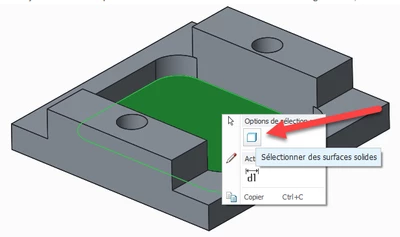

October 17, 2019
Also, instead of individually selecting solid surfaces, the quick way to add color to the surfaces of the solid model is to select on any one of the solid surfaces, then RMB "select solid surfaces". Its the little icon as shown below. (I stole this image from https://community.ptc.com/t5/Industrial-Design/Select-All-of-an-Imported-Part-when-Copying-a-Geometry/m-p/102863/highlight/true#M1473
