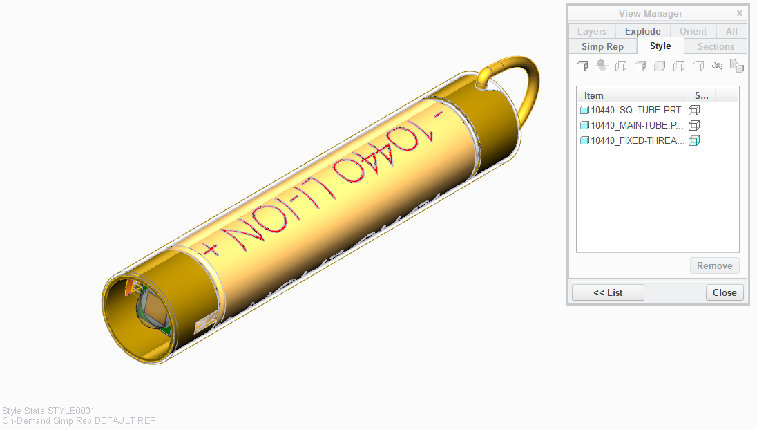

We design machines and many of the parts are purchased, we do not know the exact dimensions but want to undertake the design work. We will use a part that is close from our library until we are able to finalize the details. We want to be able to identify these parts as incomplete and in need of finalization by just looking at the assembly drawing. We need a method to make them stand our from the other final parts so we don't go to manufacture with incorrect details in the drawing. Does anyone have a trick they use to accomplish this?
Best answer by TomD.inPDX

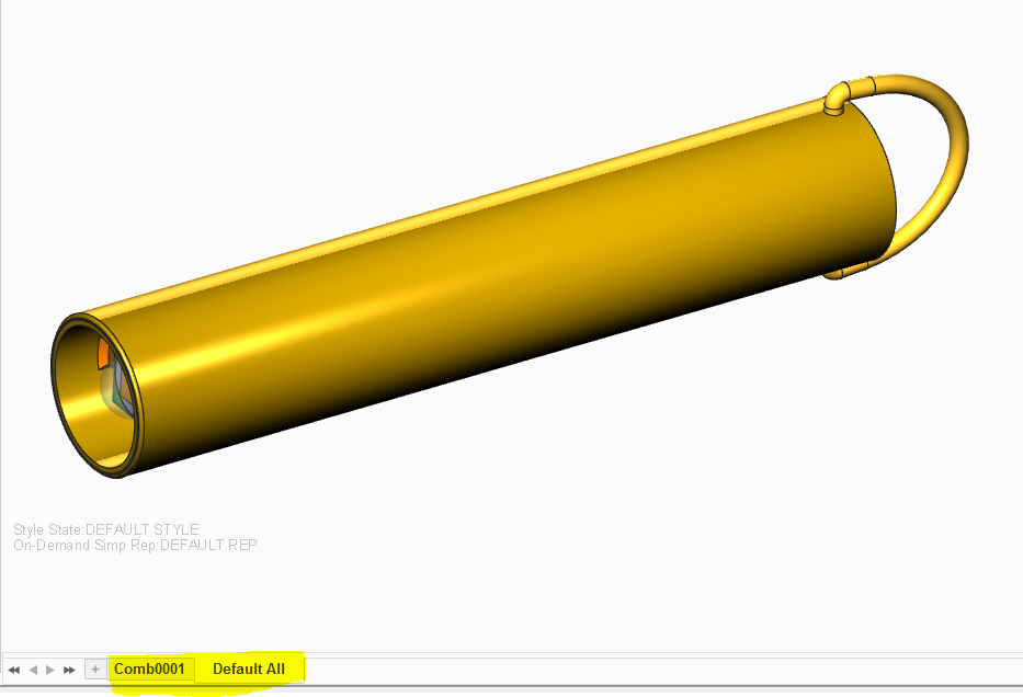

In that case, what do you think about display states where WIP is in some other state than shaded. You can then toggle this state at will and remove them from the your components as they are completed.
You probably want to use combined states to get the toggle at the bottom of the screen.
In this example, the WIP is either wireframe or transparent.
The combined states will give you an easy toggle.
