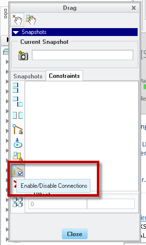

I have an assembly with a number of flip platforms. I have created them with pin connections and am using mechanism analyses to drive the assy into different configurations using servo motors on the pins. This works well as long as I am careful with the constraints so I don't lock up one or more of the connections.
These flip platforms also have guard rails and ladders that need to be installed or stored depending on the configuration. My current method is:
  1. Run the mechanism analysis for the desired configuration.
  2. Edit definition on all of the different guard rails and ladders and enable and disable the appropriate constraints.
  3. Update the snapshot of the individual configuration.
My model has grown more complex and step 2 is becoming quite tedious. I loathe family table assemblies and they are forbidden here as well, so I will not/ cannot use them. Is there something I can use in Mechanism, to switch between them?  I have tried using Rigid connections and was then hoping I could use the enable/disable connections constraint in Snapshot. But the Rigid Constraints were not selectable when I tried that.
I would love it if there were something I could set up in my mechanism analysis that would work.

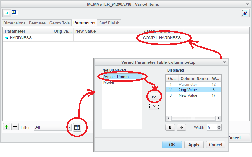

August 31, 2016
I'm not sure, but I found that when I wanted to write assembly or component level relations involving flexible components that go more than 1 level deep, then I had to use "associated parameters", which are parameters that are bound to the flexible component instance and available for controlling at the parent-assembly level.
Please read up on this, this is how they are defined (their access is hidden by default and a column needs to be added to the varied item table):
So keeping the figure above in mind, suppose this MCMASTER_91290A318.PRT is being assembled and made flexible and ends up with FID of 24412.
Now suppose I want to change the value of the HARDNESS parameter for this component with an assembly level relation:  The code you listed is analogous to doing this:
HARDNESS:FID_24412 = "Rc60"
This would seem to be the logical way, and it would be accepted without immediate errors - but usually warnings about flexible var dims being re-set would start showing up in your message logs and you'd in general get weird results.
The correct way is to control the value of the HARDNESS parameter for this component by changing the value of the associated parameter "COMP1_HARDNESS":
COMP1_HARDNESS:FID_24412 = "Rc60"
That's the way I taught myself; I don't know why it works like that, but try and see if it works for you.
