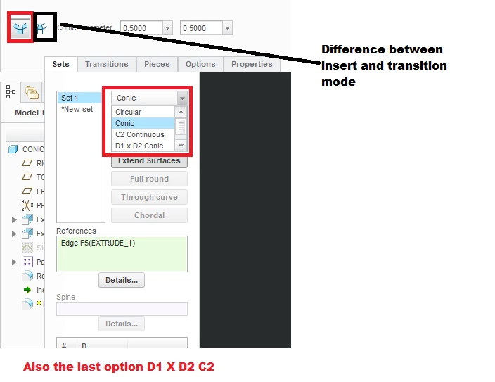

Is there an explanation/guide of how different options of rounds work in Creo?
  • July 4, 2019
  • 0 replies
  • 849 views
I want to know what curves are used in generating the rounds. If not exact curve details are provided, I would at least like to know at a high level what sort of curves are created when various options of rounds are used.
I did some research/ trail-n-error to know what curves the first two options generate.
Circular: Most basic, inserts a circle of the given radius with the same distance from edges
Conic: Inserts a parabola if the conic distance is 0.5
                          ellipse if <0.5
                         hyperbola if >0.5
I am sure about inserting parabola at 0.5 because I was able to reproduce the parabola equation. I am not entirely sure about ellipse and hyperbola.
Highly appreciate your help on this.
