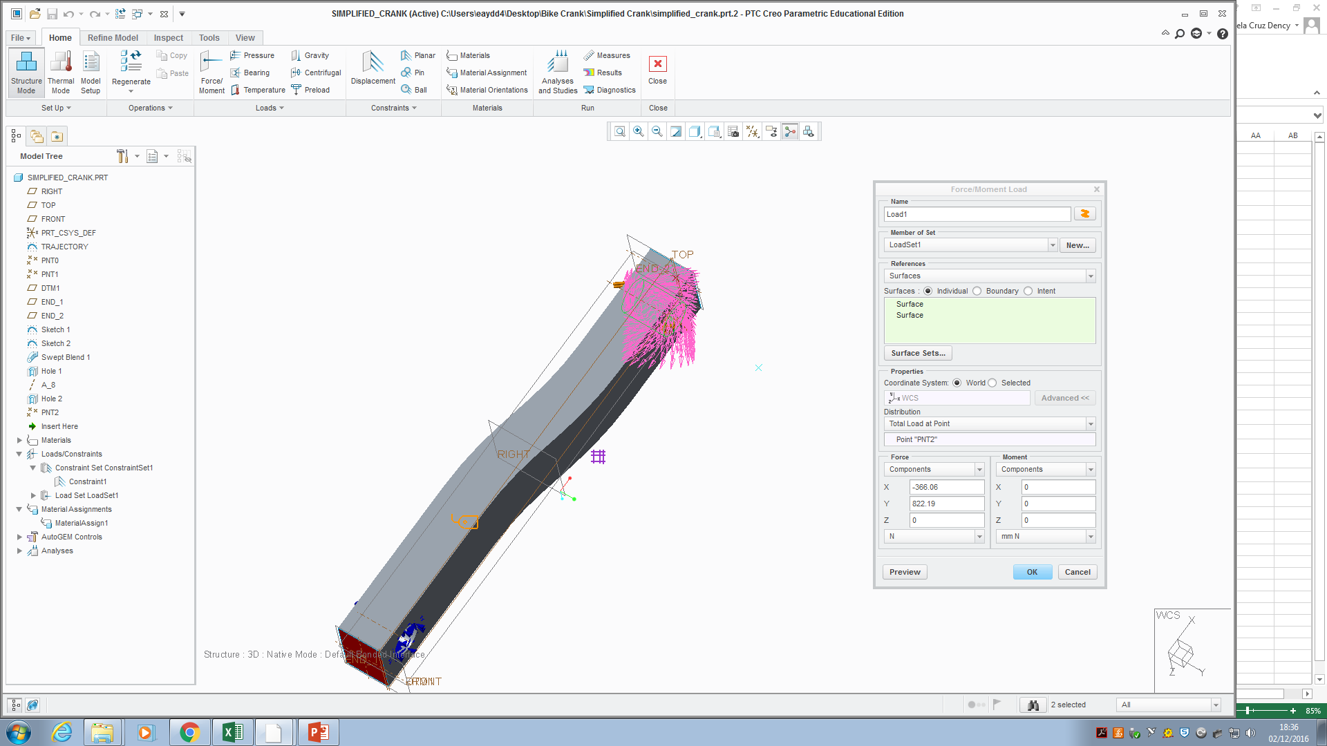

I need to run an analysis for a bicycle crank arm. The model provided is only the crank arm and it doesnt include the pedal platform where the pedal load is being applied by the rider. is there is an option of setting the pedal load as a remote force applied on the hole surface (where the pedal shaft connects)?
Your help will be highly appreciated

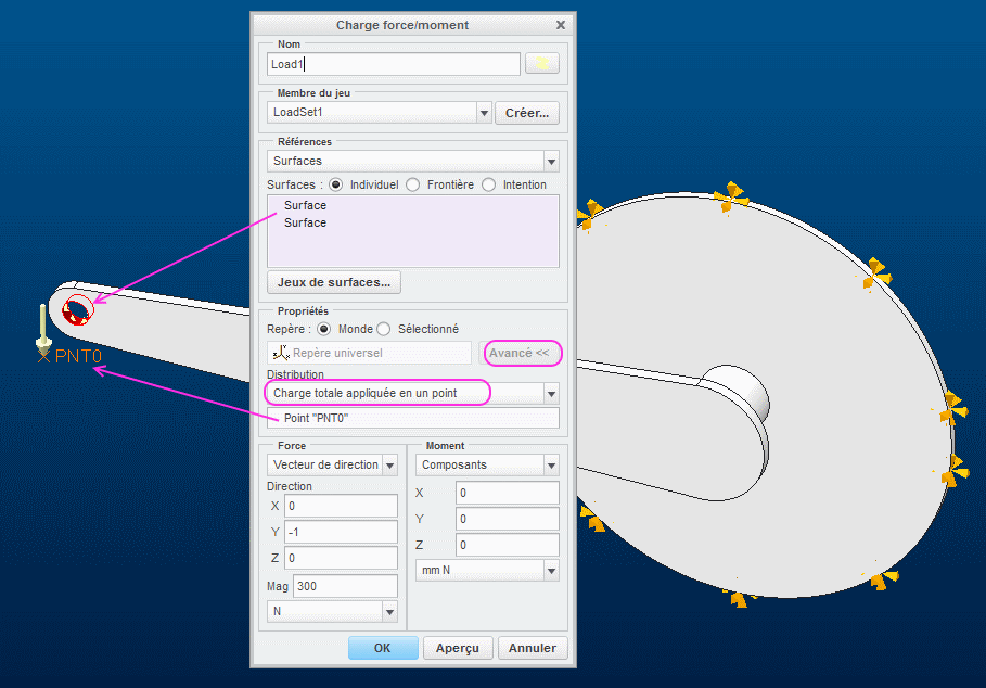

If I understand clearly your question, Yes this is possible.
First create à point on your part representing the center of the missing pedal.
Now in mechanica apply a load on the surfaces of the axis of the pedal. Then choose "Advanced" , "total load apply to a point" and select your point.Capture.PNG

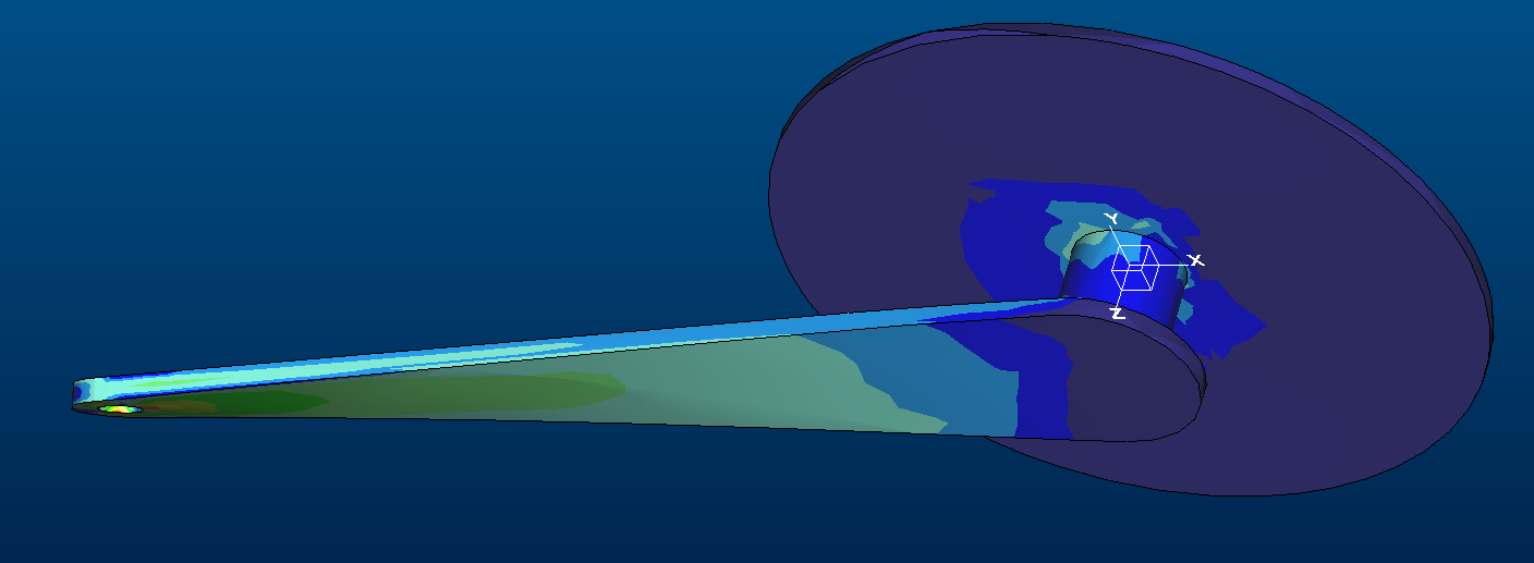

That should give you this kind of result :
Best regards
Christian

ddelacruz1-VisitorAuthor
December 2, 2016
Hi Christian,
Many thanks for the reply! I have tried doing this method and got the following result..
The force is not being applied to the point like in your example and Im getting a weird looking load being applied on the surface instead. I need to set the components of the force as 822N and 360N in the y and x directions respectively to simulate the worst case loading on the crank at a specific angle. Would you know how i should go about this? Thanks
December 2, 2016
Possibly you are using a different version that displays the load differently.
Why not create a feature to simulate the crank?
