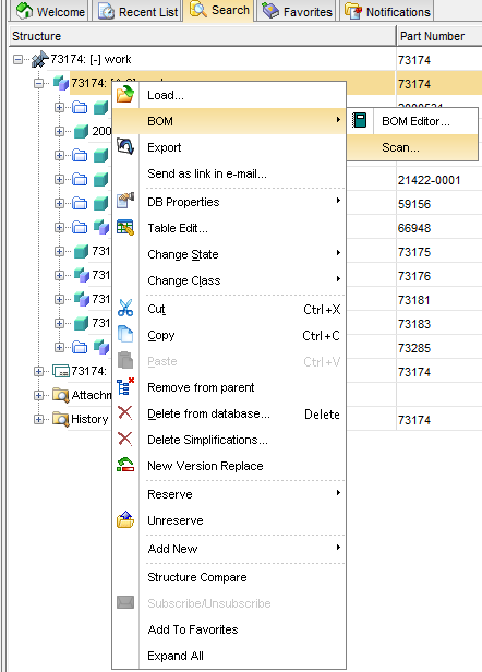

January 19, 2017
In Model Manager, right click your assembly and select BOM>Scan. This allows you define the depth of the tree to scan.
Then in the BOM Editor you can send to MS Excel.
Mike
January 19, 2017
The question was how to get the data from the Structure Browser, not Model Manager. Your method is fine if you use Model Manager and have a license for the BOM module.
January 19, 2017
Sorry, I guess I'll consider myself lucky for having the BOM module.
I only mentioned it because your method of turning on "Details" did not work in my test. The TXT file was the same in either case.
Thank you.
