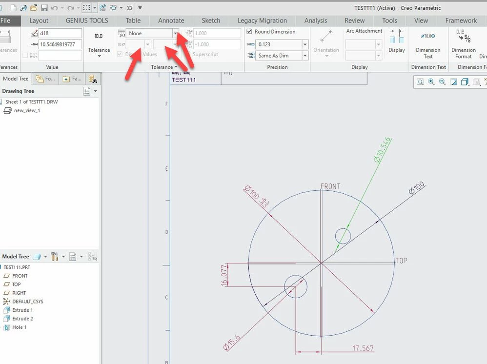

I am having trouble figuring out how to get the tolerance tables to work.  I am not able to select hole or any of the values.

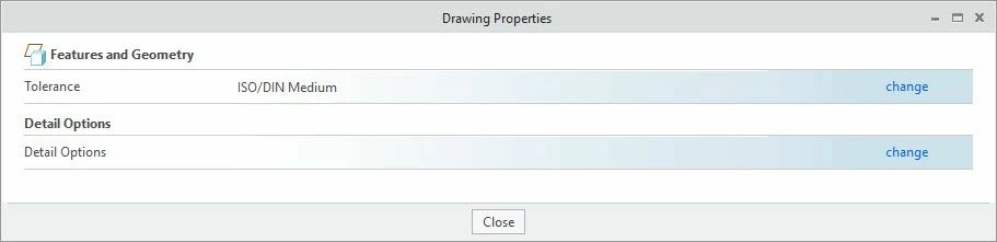

 I have enabled the ISO/DIN Medium Tolerance mode and loaded the tables.  I have also loaded the DIN.dtl.
Any help would be appreciated.
Thanks in advance.

I'm not sure - because you use Creo 4.0 (I'm on Creo 2.0), and also I'm guessing from your screenshot: but you seem to be loading the tolerance tables into the drawing?  And the dimensions you are concerned with - are they "shown" dimensions, or are they drawing annotations?
In other words, is the dimension you are trying to change named d1 or add1?
If it's "add1", then it should work.  If it is a "d1", then you need to load the hole tables into the model and assign the fits to the model dimensions.

@pausob I tired that but not success.  I believe there is a bug in Creo 4.0

Hi There, I've been having the same problem today. Eventually managed to work it out though.
I added the following config options.
tol_display = yes
tolerance_class = medium
tolerance table_dir = 'you'll need to work this out for yourself' (creo install directory probably) look for *.ttl* files
Then in the model I had to load the tolerance tables.
in the model go to..
File\prepare\model properties
in features and geometry there is tolerance
change (you may need to change std too)
tol tables
retrieve
select all in the list which should come from the location above (use shift key to select all in one go)
You should now be able to select plus/minus and then the box will give you options general\broken edge\shaft\hole from there you can select H6 or whatever you need.
