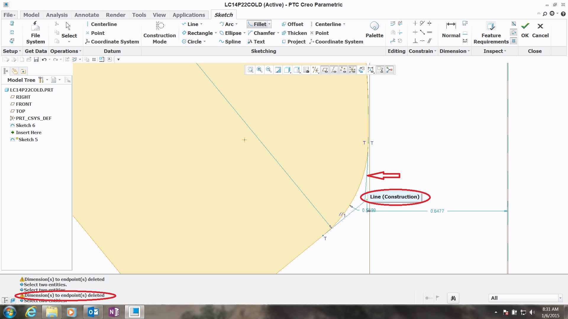

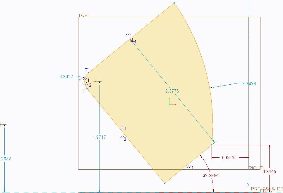

I'd like to submit my top irritation with Creo. NOTE: This is already represented with what you zhao copied (4. Sketcher dimensions that stay put), but my request is more specific. I will copy my user idea submission.
Fix radii in sketch constraints so it doesn’t come unglued when the radii is modified.
When modifying the original value of the fillet in a sketch there are 2 different conditions that are causing constraint related failures.
1) 1) When there are 2 intersecting lines that are not in the horizontal or vertical position.
2) 2) When there is an intersection between entities that are not lines.

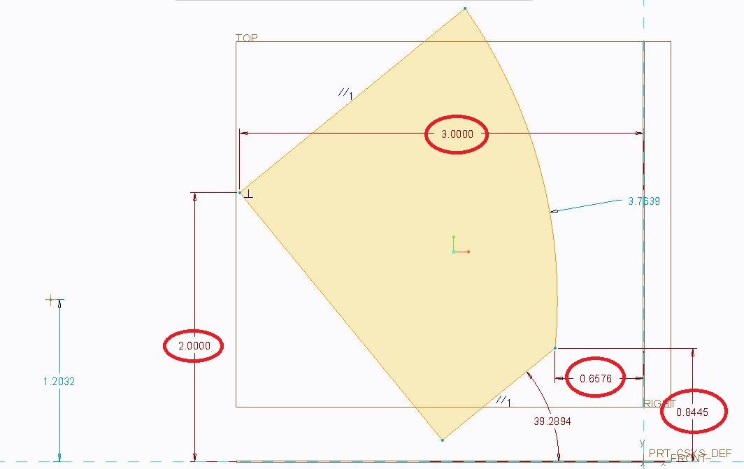

With the shown example I have locked the dimensions that I need to keep the sketch stable.

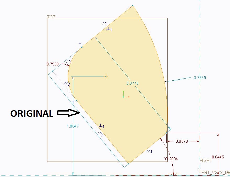

With case 1 even though the intersection is dimensionally locked when a fillet is applied it replaces these constraints.

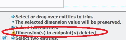

Creo even recognizes the error it creates as shown below.
When you modify the fillet to the needed size it will invariably move the position as shown.

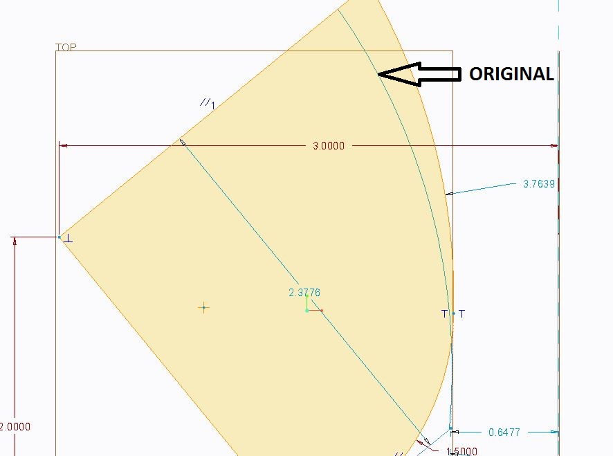

With case 2 instead of having 2 lines I have replaced one of the lines with an arc. (The same type of results apply with using a spline), once again when I place a fillet it removes the original locked constraints. Once again in the message tree you see the “Dimensions to Endpoint Deleted” error. Additionally another troublesome entity is introduced. Notice that the system replaces out what should be a construction arc with a construction line.
When you modify the fillet to the needed size it will invariably move the position; see below.
With case 1 the work around is to replace the dimensional constraints with the original locked dimensions. This allows the constraints to work correctly, but it adds this extra step every time. If the locked dimensions truly were locked this would not be necessary.
With case 2 the work around is more complicated. The replacement of what should be a construction arc with a construction line means that I can’t just add X and Y locking dimensions to make constraints work correctly. The construction line tries to match up with a tangency on the arc and depending on the size of the fillet can really distort the results. In order to fix the constraints you have to extend the arc back to the original intersection (prior to the fillet), divide the arc at the place where the fillet intersects it, change the arc to a construction entity and then add the X and Y locking dimensions. If the locked dimensions were truly locked and if the construction entities at the intersection retained their original entity type the work arounds would not be necessary.
January 15, 2015
Hi Paul...
Great to hear from you! If memory serves me, I actually documented this problem in the past and mentioned it to the PTC developers. It received a positive response (which is sometimes all you really get). Any time there are pain points like this which seem to be easily fixed, I feel there's hope.
I'll happily add this to the list and try to bring it up again. Your screen shots definitely help to communicate the problem.

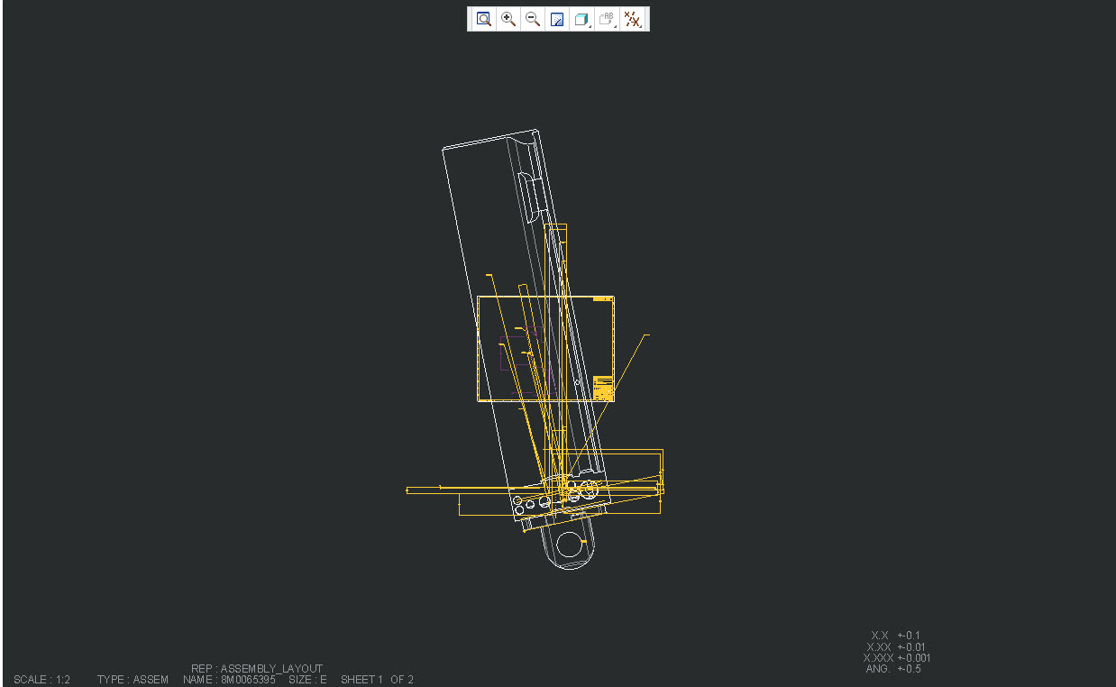

For anyone that uses mechanism snapshots in drawing views.
Please urge PTC to redesign the snapshot functionality so it's no longer dependent on the explode state software code. The way the snapshot funtionality is designed if a component is changed, any snapshot that references the part becomes out of date and you have to update the snapshots. Let's say you modify a edge radius, but the position of the components do not move related to the change you made. You still have to update the snapshots and if you open a previously saved drawing you can't even see the assembly because the part is scaled in the drawing to show you something has changed. Pleae have PTC fix this. example image attached of a drawing where the cylinder is scaled up 100 times in size hiding an assembly that is 20 times the size of the cylinder.
Current software as designed is causing everyone to do unneccary work on drawings do to a simple dimension change.
Don Anderson
January 21, 2015
Hi Don...
We discussed the deficiencies with Snapshots today. We discussed the specific issues you're having. I think we have a commitment that in Creo 4.0, we may have some modifications to snapshot which might alleviate the problems you're seeing.
Thanks again!
-BRian
