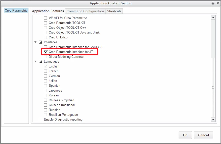

June 7, 2018
the problem is related to Creo installation. During installation you have to click Customize button and select Creo Parametric Interface for JT.
jt_installation.pngWhen you do this, installer inserts JtToPro.exe into ...\Common Files\x86e_win64\obj directory.
