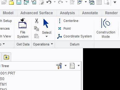

Hi Paul, i think you can do what you want to. In your active sketch, click the fly out under Select, here you will see one by one, chain, all geometry. Select chain, pick one entity in your sketch, & all chainable entities highlite. Hope this helps.
John

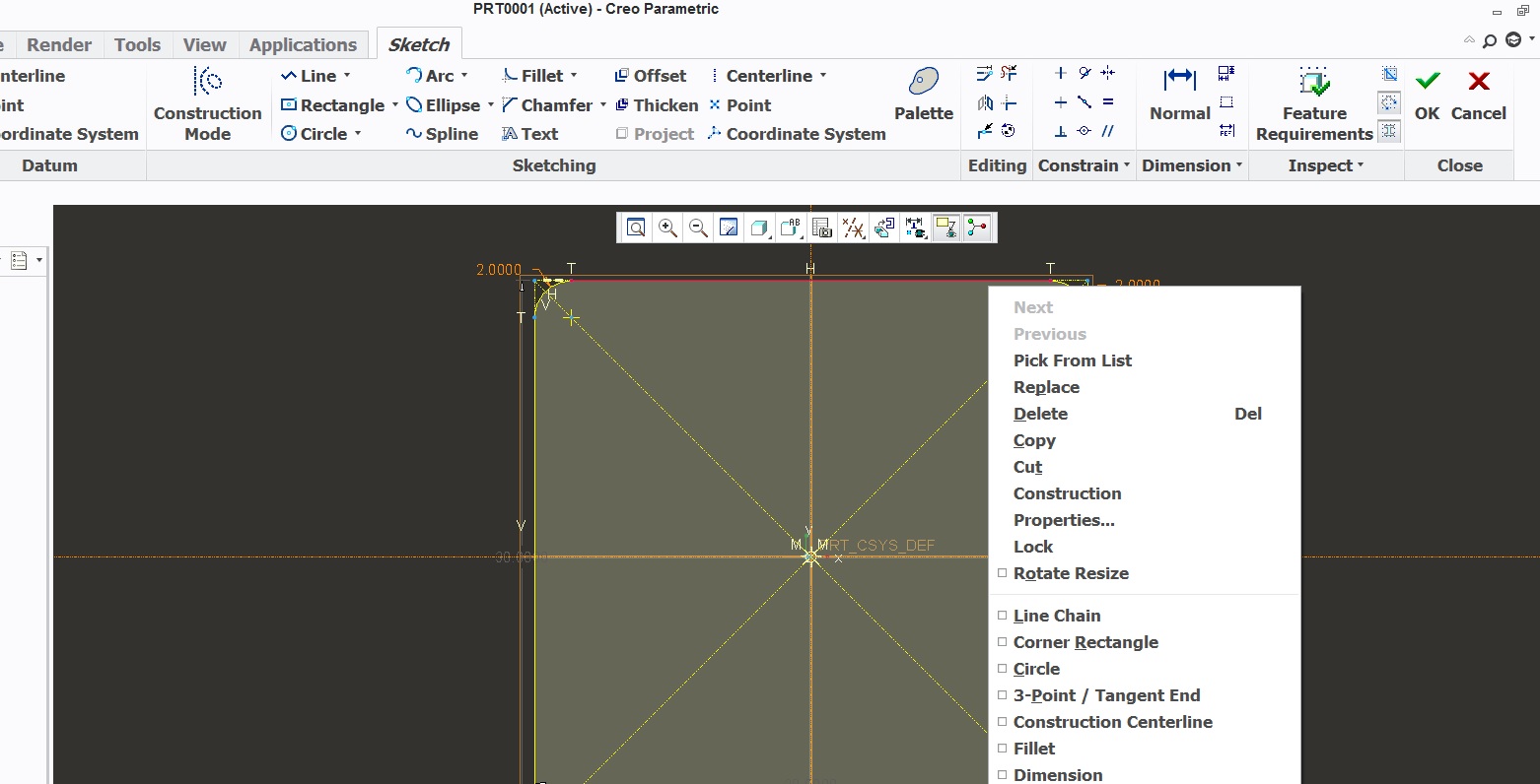

I wouldn't be able to describe this better by uploading a file. This situation is duplicated with every sketch that we create. The problem situation is that I just want to chain select the many entities that either are in an open or closed loop.
Perhaps there is a mouse keyboard combination that we are missing, but anything we've tried doesn't work. As with anything else in Creo I'm thinking that once we know how to do it, it will at that point be easy.
I'll attach a picture of an easy sketch that I created on the fly. I've picked the 1st entity and I would expect some kind of pop up option to bring up the chain select or perhaps just pick the entity and be able to chain this by selecting SHIFT. With our other CAD system we select SHIFT and LEFT CLICK at the same time which we've already ruled out in Creo.
July 16, 2014
I'm 99% sure you cannot chain select in sketcher. I'm not really sure why you'd even want to... What is your specific use case?
