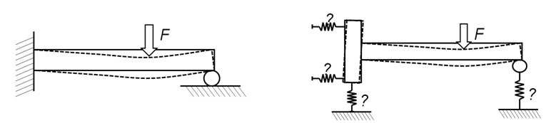

Yes it would. In statically indeterminate designs, displacements, even if they are "small", affect how reaction forces are distributed. If a contact analysis is used for such a design, large deformations need to be used, even if displacements are small, since contact is a deformation dependent phenomenon.
I often use this picture in training. In a statically indeterminate constraint case, as shown left above, the distribution of reaction forces are affected by the stiffness of the surrounding environment, as indicated in the right picture. An engineer, presented with a design proposal as in the left figure, should ask the question of what is the stiffness of the surrounding structure, and include that either as springs with realistic stiffness and/or by including the actual components in the analysis. However, if contacts are used in such a case, large deformation analysis should be used, even if deformations are "small", or else the distribution of reaction forces will be incorrect. Being able to use beams in combination with LDA would help modeling more complex structures that are statically indeterminate and have contacts.
