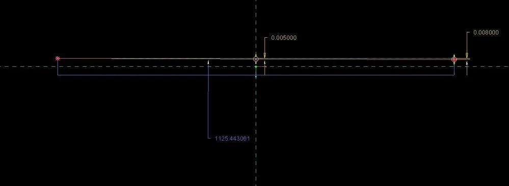

Any idea why I can not constrain the large radius to the point in the center a the 0.005"?
file is creo 2 m250
thanks!

Typically a failure of this type is a lack of available precision. You can try to change the range by setting the accuracy to absolute (if that still applies to the creo version) and use a value like .002.
You might also just use larger values in the sketch and edit them afterwards. If it's an accuracy problem the feature will fail to regenerate and you can try other values to sneak up and chose a useable accuracy value until you get what you like.

Like David said, small dimensions in a large part require tighter accuracy controls.
My early re-introduction of Creo was to make silkscreened panels.
The extrusion of the silkscreen art was only .002" on a 19" panel.
Wouldn't do it until I made precision tighter.
By default, I now change these types of features using absolute accuracy at .00005".
You have to initiate allowance of absolute accuracy.

I use abs acc of 0.0001" generally, but even 0.00003" doesn't change this. It seems to be something else.
October 19, 2017
Try going the other direction with the accuracy value, like .002 or .005.

please publish detailed information related to your sketch. I can see 3 lines and 1 arc on your picture. What are dimensions of these entities ?

I guess the only other dmiension that actually important is the whole thing is 3" wide. So it's just a really big radius in a really short distance(which appears to be the main issue anyway). I also attached the model (in the original post). But I think anything similar will do the same thing.
October 24, 2017
see attached model.
