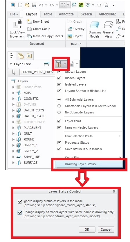

Is it possible to show the view s in two different layers control in drawing?

Two views with different layer settings is possible.
Check article  CS58372

Great article,
 other usefull function is make drawing layers independet on model layers. You can set it in drawing space. See picture below:
