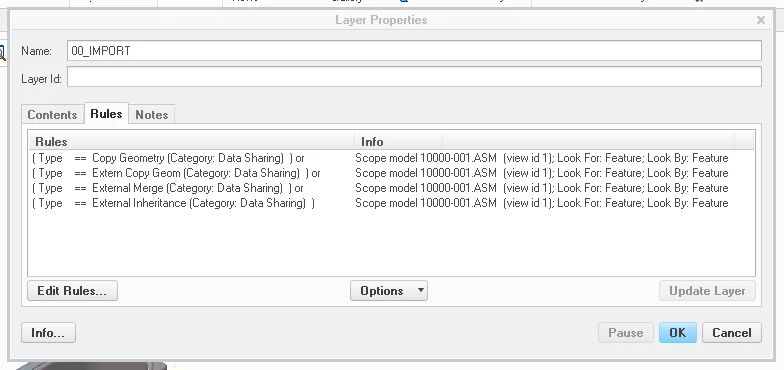

I have in my rule based layers a layer (00_IMPORT) that gathers import features. The rules are:
[cid:image001.png@01CFD7E3.4DCDBA70]
Note that it only looks for features. It works well, all my copy geom & merge features end up on that layer.
However, if I build an assy with sub assys and with dedicated skeletons at the sub assy level, I start to get quilts and other entities on that layer in the parts in the sub assy. The quilts in particular cause problems.
For example, I create a quilt in the main skeleton A and publish it to sub-assy skeleton B. In skeleton B the copy geom ends up on my layer. I then publish that quilt to part C. In part C the copy geom and the quilt end up on the layer. Because the quilts don't follow the same rules as features and entities, I cannot show anything without getting the quilts too.
How do I stop these quilts (& other entities) from showing up?
