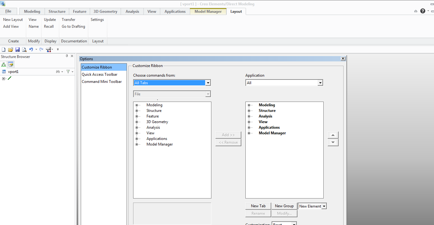

September 19, 2013
What I also don't understand, is why Layout doesn't show up in the list of All Tabs in the customize dialog.
(see attached images)
Mike
