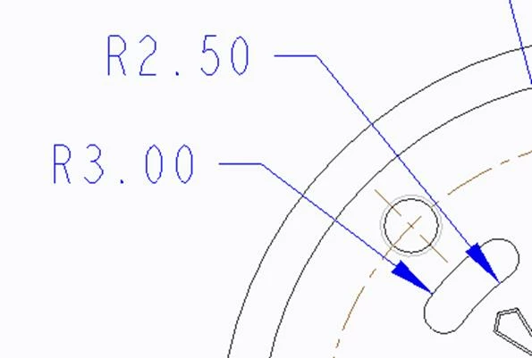

I have Creo Parametric 2. I am working on a drawing that has radius leaders.
I can move the dimension text and flip the dimension text, but I cannot
control the length of the "dogleg" portion of the leader.
I think that this might deserve a graphic...be right back.
Mike Locascio
August 19, 2014
Click the dimension and then hold shift+LMB... you can move it anywhere you want on that line
